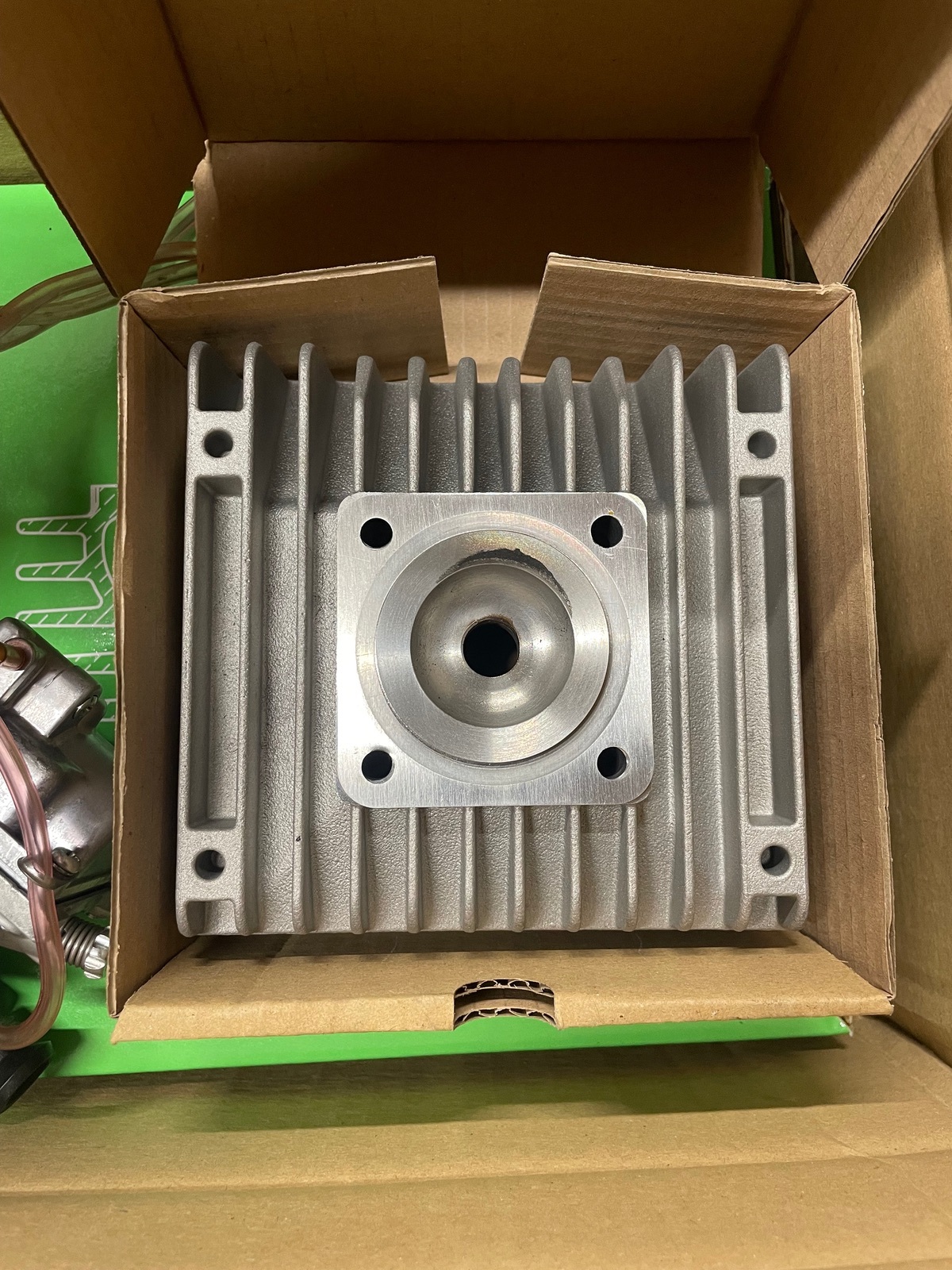

Hier nochmal bessere Bilder:
https://s20.directupload.net/images/user/240428/zy7qsin9.jpg
https://s20.directupload.net/images/user/240428/hm8objuu.jpg
https://s20.directupload.net/images/user/240428/u9zwmcel.jpg
https://s20.directupload.net/images/user/240428/dy88wy84.jpg
https://s20.directupload.net/images/user/240428/z7bd226e.jpg
https://s20.directupload.net/images/user/240428/mra8snnu.jpg
https://s20.directupload.net/images/user/240428/7fjegj6u.jpg
https://s20.directupload.net/images/user/240428/6onunt8g.jpg
https://s20.directupload.net/images/user/240428/l5qu7m5u.jpg
https://s20.directupload.net/images/user/240428/eql7o9tp.jpg
https://s20.directupload.net/images/user/240428/clp7qf99.jpg
https://s20.directupload.net/images/user/240428/juss32uu.jpg
https://s20.directupload.net/images/user/240428/5bu5jdpx.jpg
https://s20.directupload.net/images/user/240428/8cghsyxa.jpg
