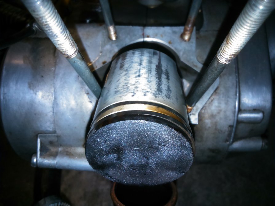

  • OK. Its 60/2 (not from original DDR.., but from Poland), 16N1-11 (nozzle 78) with original air filter (but with microfilter from vacuum cleaner :-)). And secondary sprocket is 15.
    BTW..Is this piston bad? (I think that shiny strips)...The speed is quite good (about 70 km/h), so i don't think that cyllinder is seized.
    [ATTACH=CONFIG]10663[/ATTACH]
  • It looks like sharp edges around the intake which u should smoothen with sandpaper. But its only a guess.
    Are those shiny stripes all around the Piston? Or just on the intake side?
    S51E
  • As long as the ringzone is ok, i would smoothen all edges and give it another try.
    Maybe the Piston is slightly too big ,the best would be to measure it correct but u need special tools for that .
    If there is a motorbike garage in your neighborhood they could probably answer that question but the Piston is not the best anyway. Is the Cylinder from Stock or has it been modified?
    S51E
  • The cyllinder is from poland, and seller said that is from final manufacturing, not from original ddr cyllinder (but the ports looks the same as original, even dimensions). And the piston quality is quite worse than original 50ccm piston that I have with stock cyllinder.
    But as I said, the power is quite good, but only above cca 7000 rpm. Under that i lazy :)
