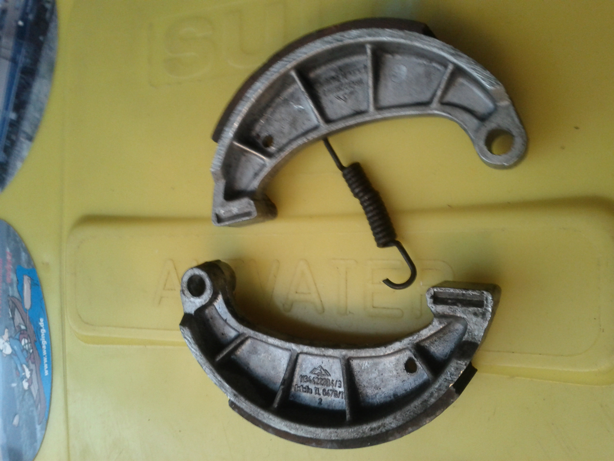

    3.Sind das originale DDR Bremsbacken also mit Asbest?
    http://s7.directupload.net/images/121227/xdv9lr7j.jpg
    http://s14.directupload.net/images/121227/xny5kb6k.jpg
