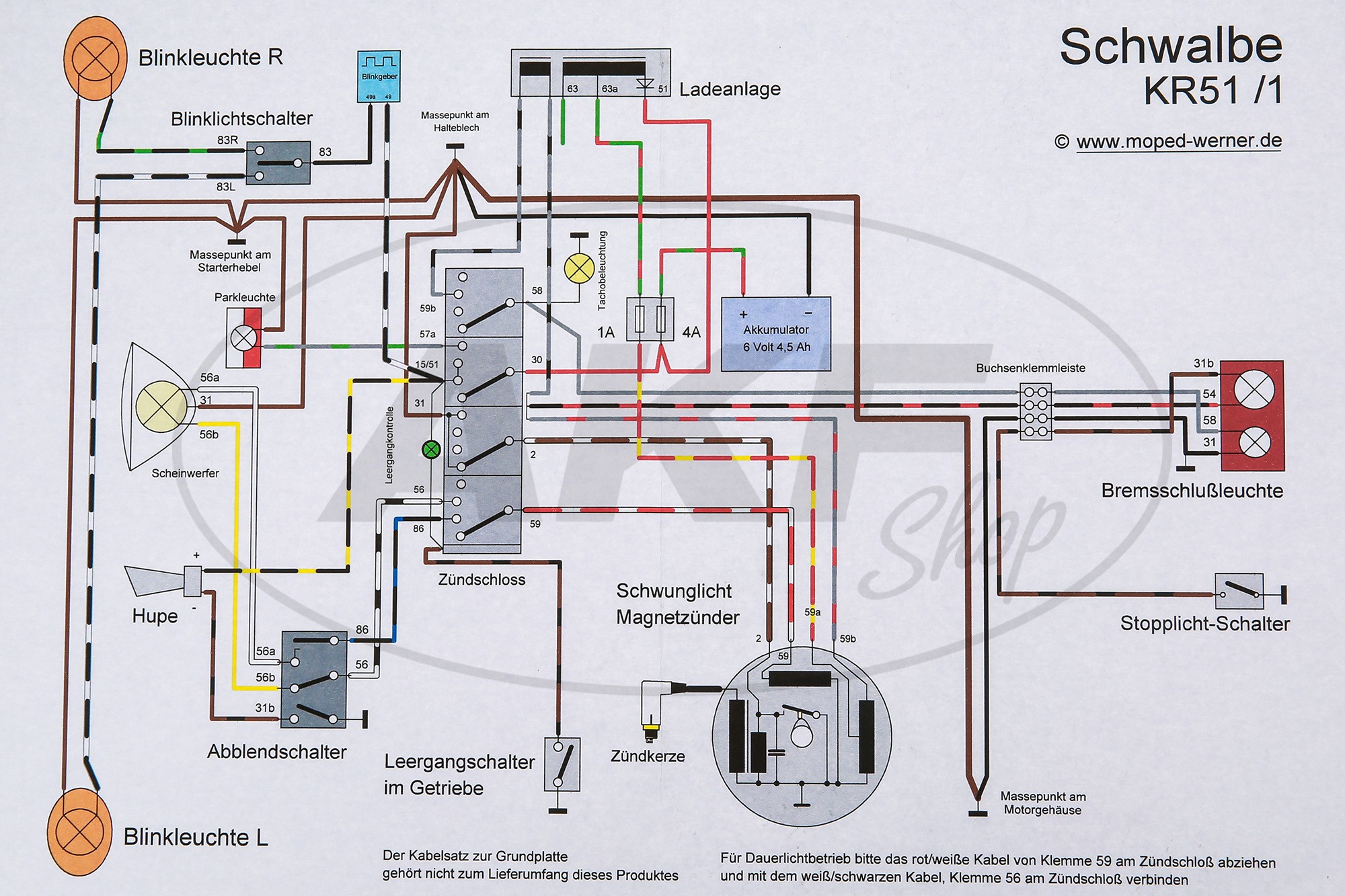

Ok thanks for the advice.so my problem is the ignition switch does not stop the motor i have replaced the switch and checked the connetions there is no power coming from the switch to the lights or indicators but 6v going in on number 30 my bike is kr51/1 with contactors .engine starts without key.????sorry about the English
There has to be a connection between number 31 of the switch and ground. If this doesn't exist, you have to put an electric wire from number 31 of the switch to ground. On number 2 of the switch has to be the brown/white electric wire comming from the igniton (4 elctric wiring comming from the engine housing - one of them is brown/white). If these two cables are do exist, the switch could be broken.

Try to read the wiring diagramm find the mistake at your wiring harness.
Please figure out if you have not mistaken the numbers on the switch up/down, it's a bit confusing. Try to search for a single wiring point and you can see if you have wired it the right way
