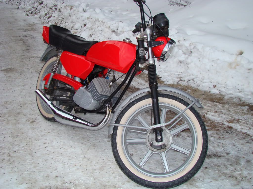

    [Blockierte Grafik: http://i929.photobucket.com/albums/ad131/turbouffe/DSC04326.jpg]

    think there's no identical part between Sachs and Simson, because Simson was produced in the former GDR and Sachs in West-Germany. Maybe you can find some identical parts on Hercules, Sachs and Zündapp as well. But all I know about these bikes is great lack of knowledge. :D
    Your Hercules looks really cool. Just keep it up.

    Also to other bikes from west germany there are no parts which are same- all this companies had big fights together on the market in the 70th and 80th.
    Hm, but why does Herkules use parts from Sachs (like wheels and engine, see picture above).
