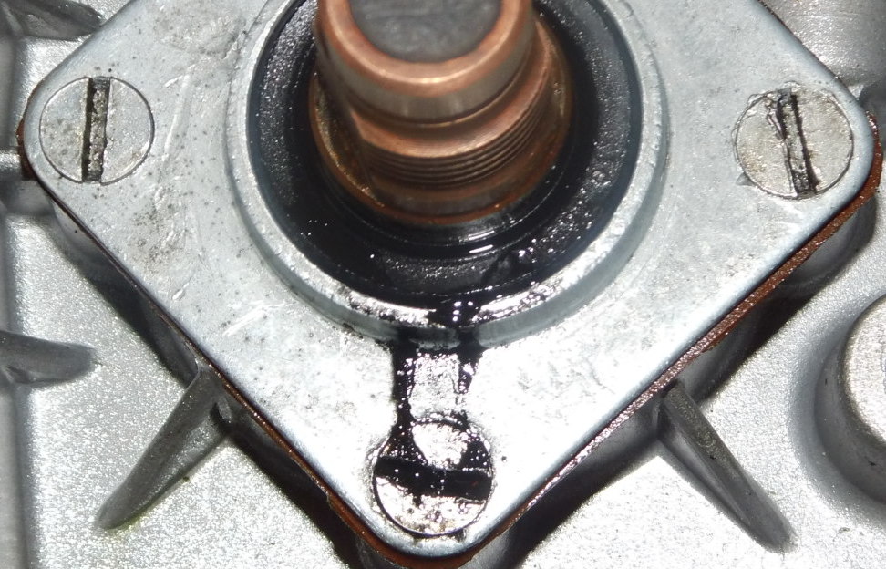

    Currently I'm testing a new solution - "oil guide disk" has been completely removed.
    I noticed considerable wear NBR oil seal after driving 3500 km. I have read that the use of "oil guide disk" results in decreased lubrication of the sealing, so durability is reduced.
    Removing the "oil guide disk" causes some complications. In the original alternators (breaker and electronics) shaft seal may fall. I have the alternator from Langfang Kokusan and machined stator base, which can prevent the falling out of the shaft seal. Also, there is no problem in alternators Vape / PVL.
    This solution is used in the engine, which I do not use every day, so you have to wait for the results.
    PS. My SR50 is still running. 37000 km mileage.
