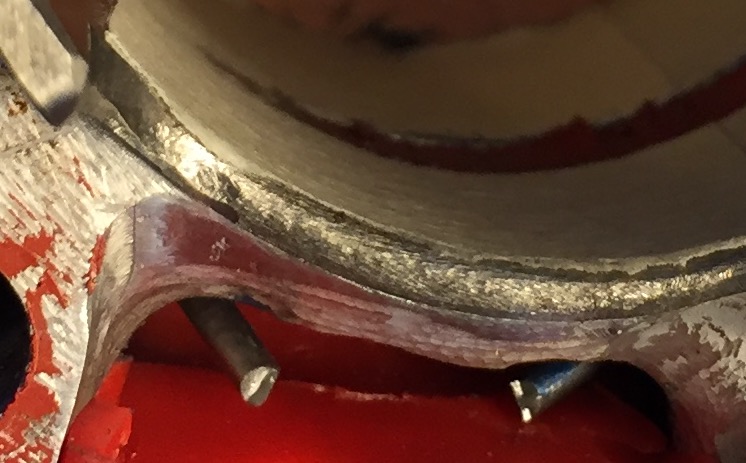

  • Alright, thank you for the quick reply. I was thinking about 1.5 mm, because when I'm using a reed valve I don't really need to be sealing the crankcase, since I'm making a hole in the piston. 1.5 mm I think should be sufficient, any less might cause problems. I'm going to be taking the cylinder off today and will order jbweld to change the uberstromer flushing angles (horizontal and vertical), because when I made the cylinder I didn't think of the importance. Anyone has experience with jbweld in the uberstromer? I can show some pictures of the cylinder after I'm done.

  • Zitat von HerrSchmidt
    JB Weld works fine.
    But i would set two steel pins for more grip.
    Hello, I will definitely do that, it looks like a good method, although I'm going to use it on top of uberstromer. Don't know if you can see but the flushing angle is too big vertically, I guess it affects performance.

    Hallo, Ich werde das machen. Meine horizontal und vertikalwinkel, wenn du siehst in der bilder sind schlecht. Ich werde hochladen portmap bilder bald. Wenn sie haben tipps zur verbesserung der zylinder ich ware froh von dir zu horen.
