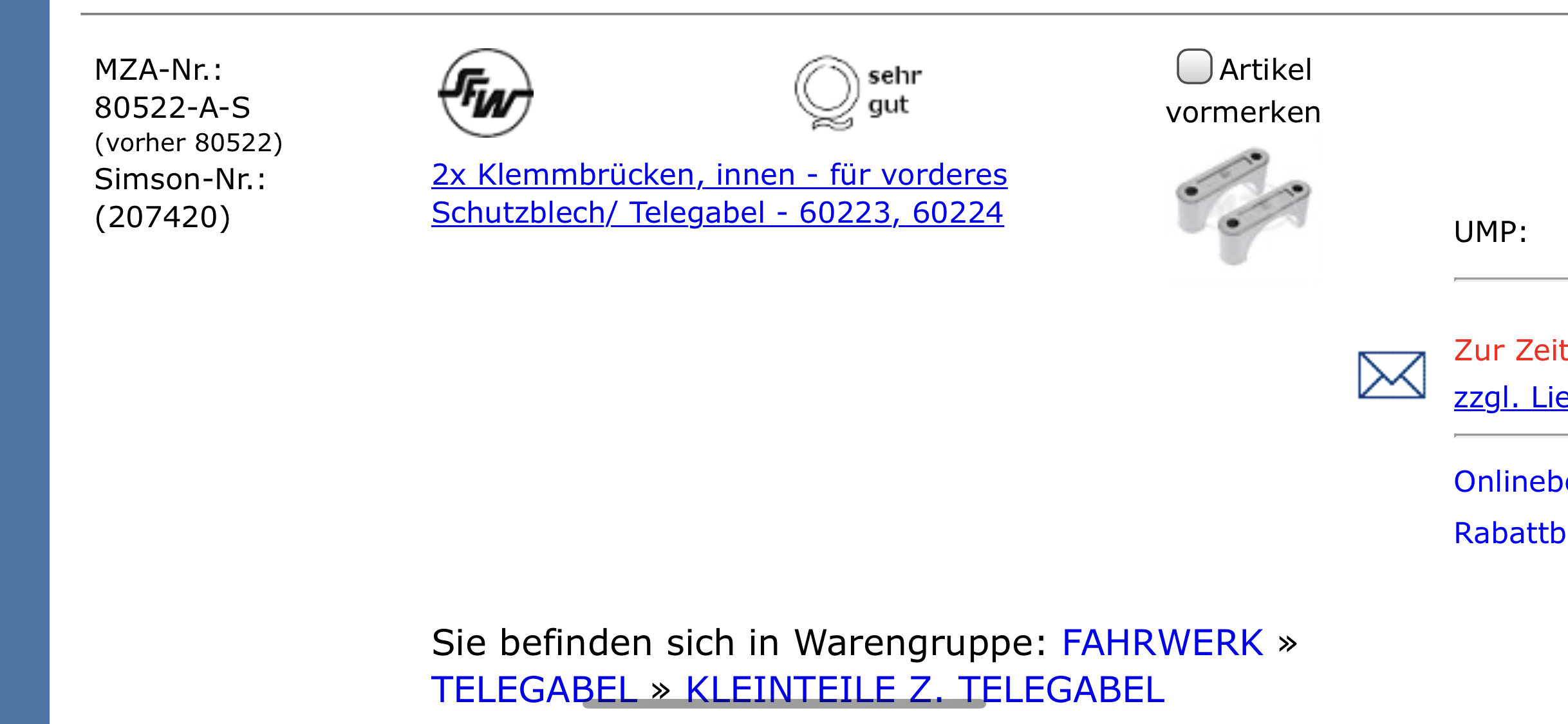

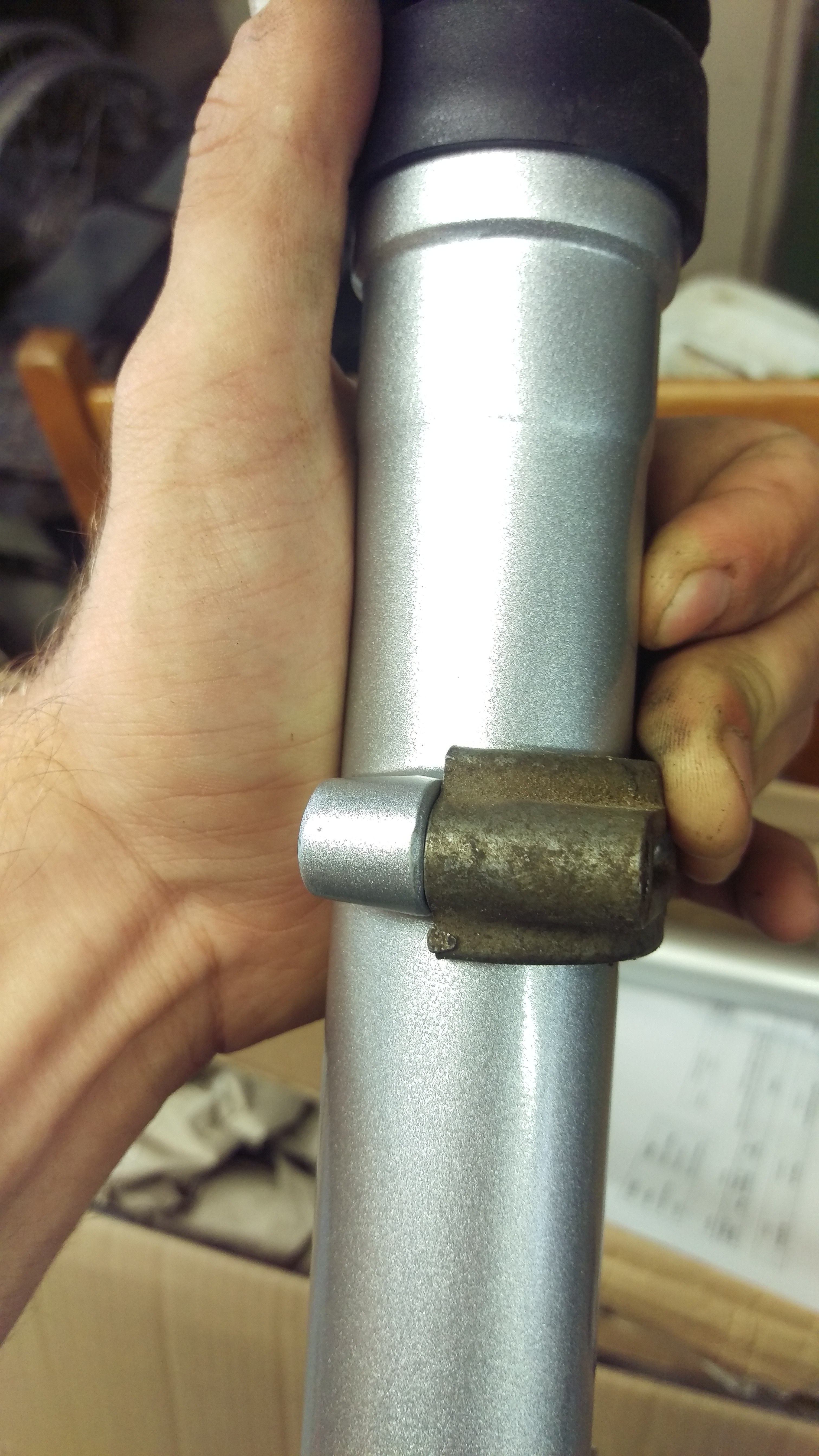

MZA hatte für die Gabel auch neue Halter für den Kotflügel angekündigt damit es hier nicht mehr klemmt.
Davon hört man auch nichts mehr.
Oder habe ich da was verpasst?
Würde mich auch mal interessieren...

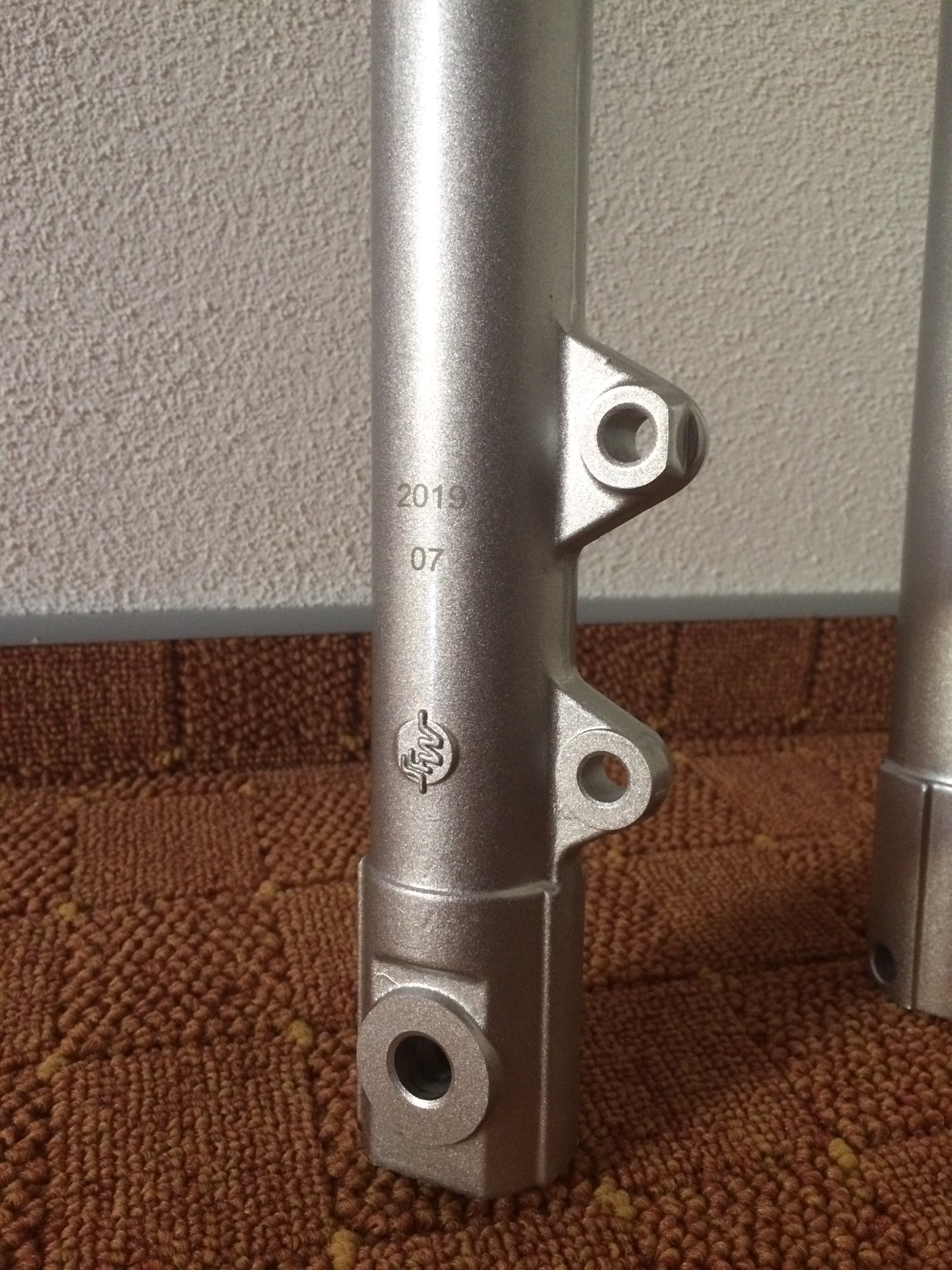

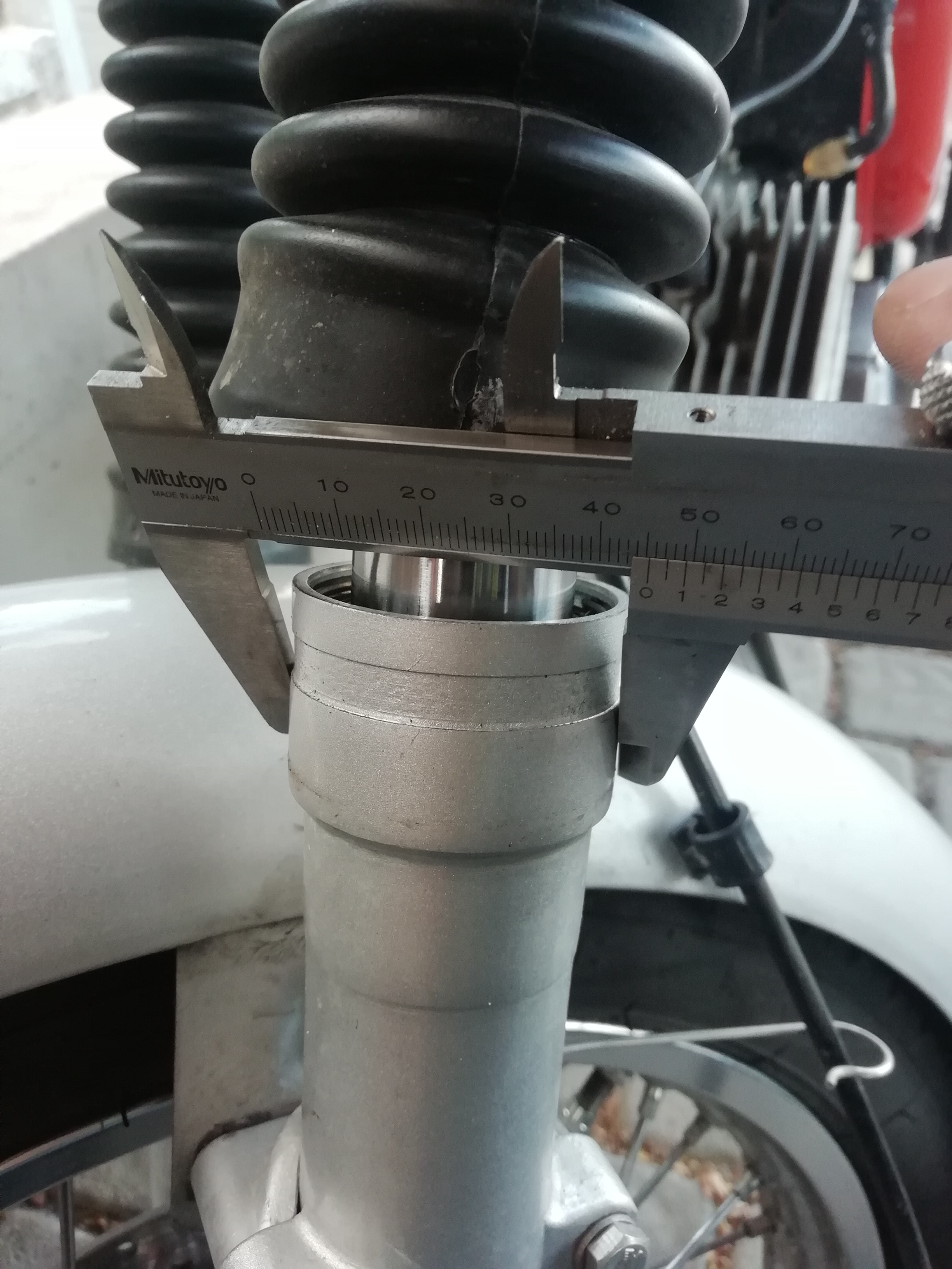

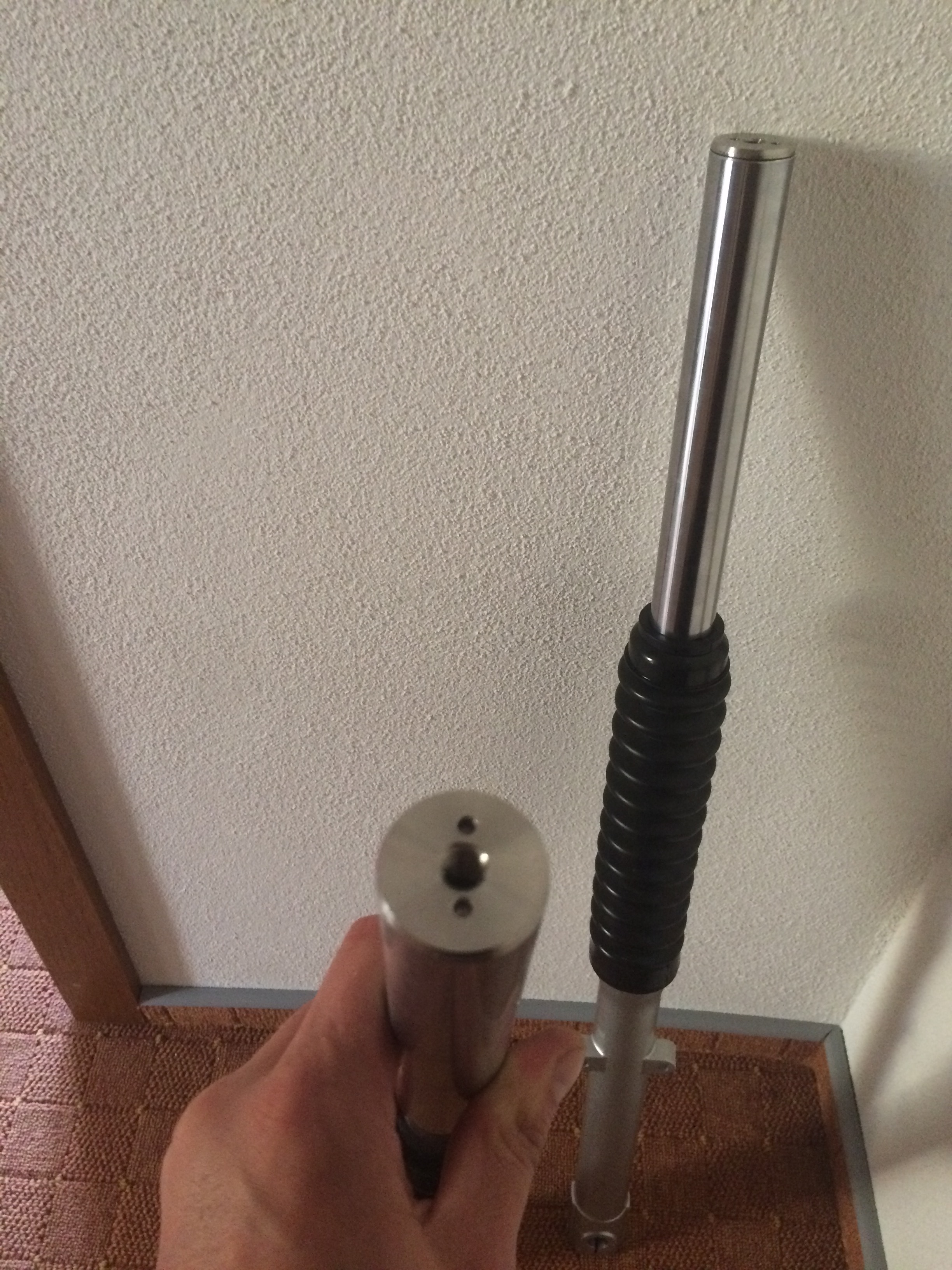

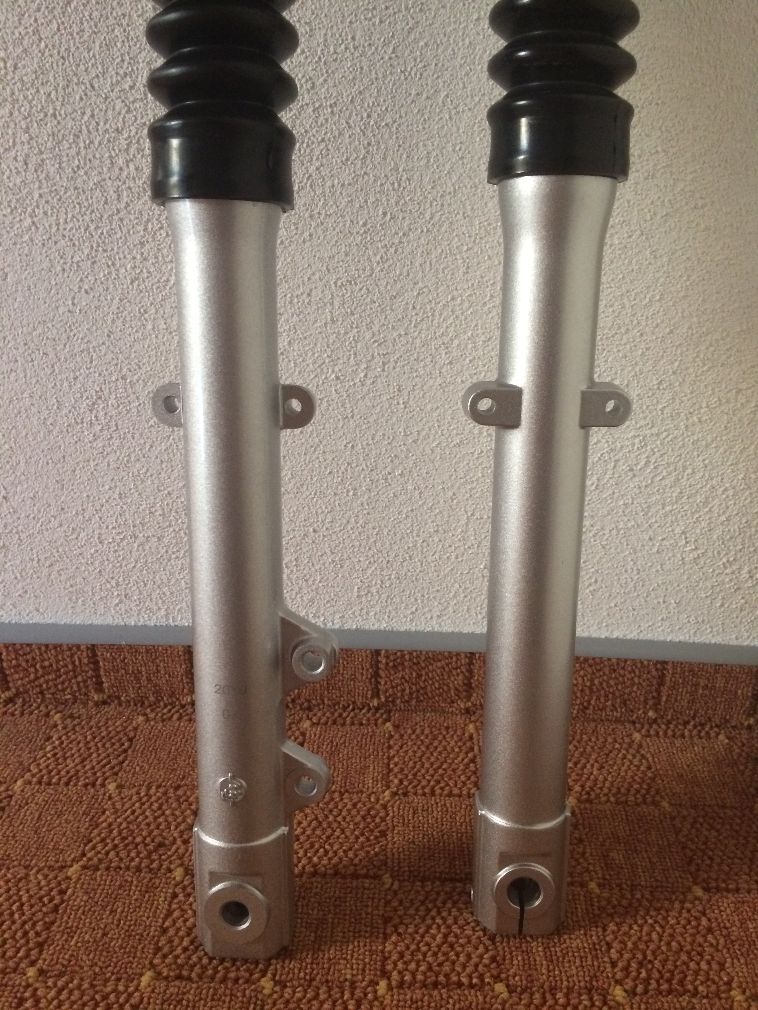

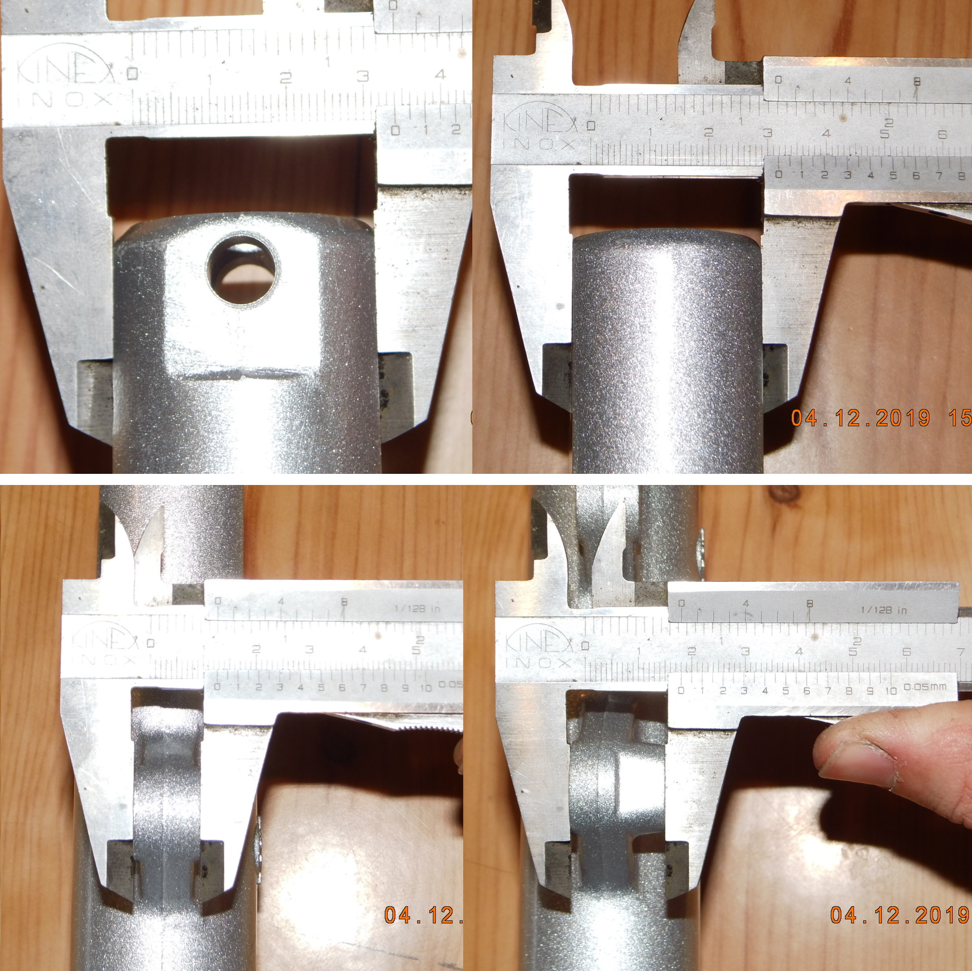

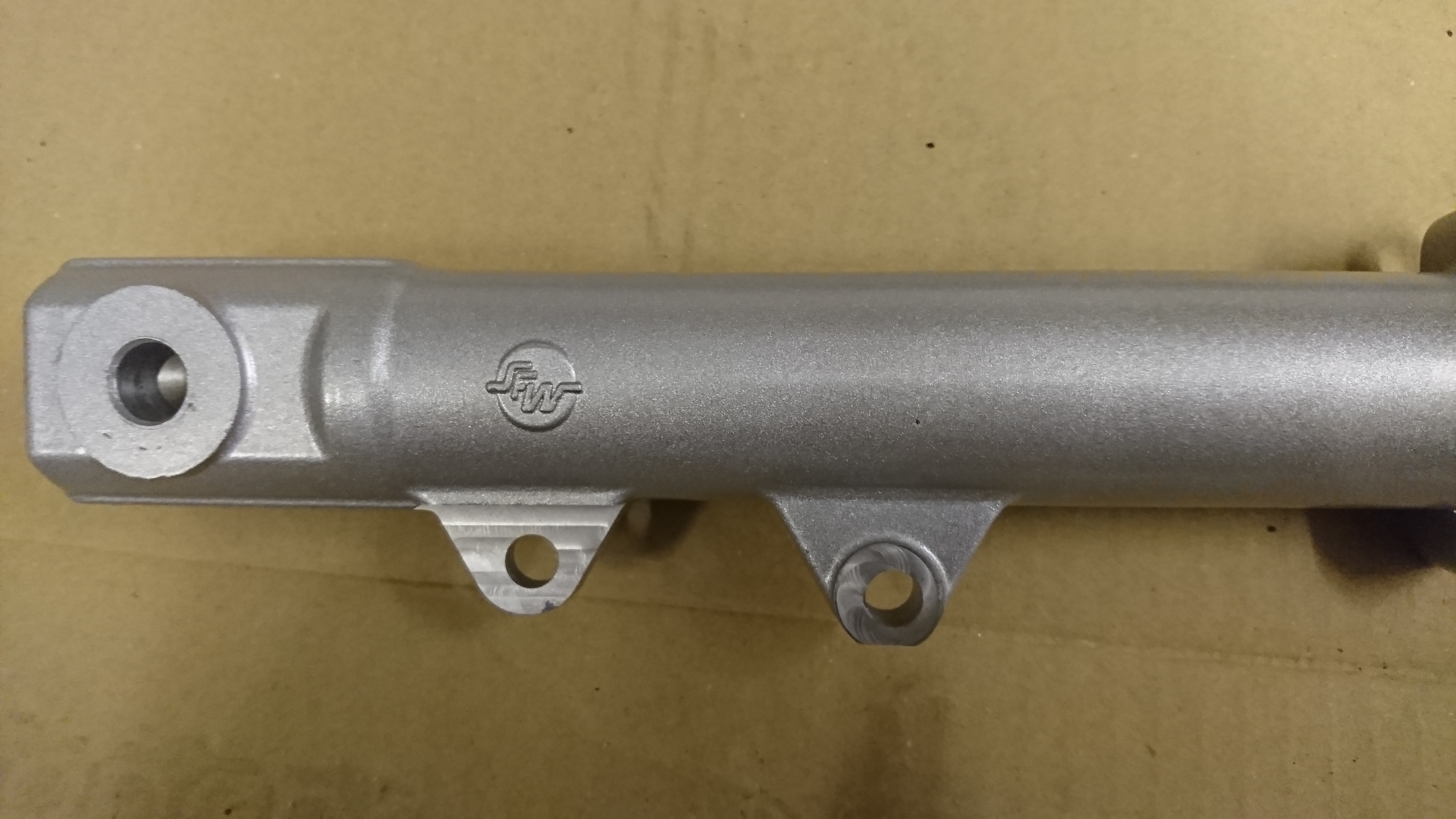

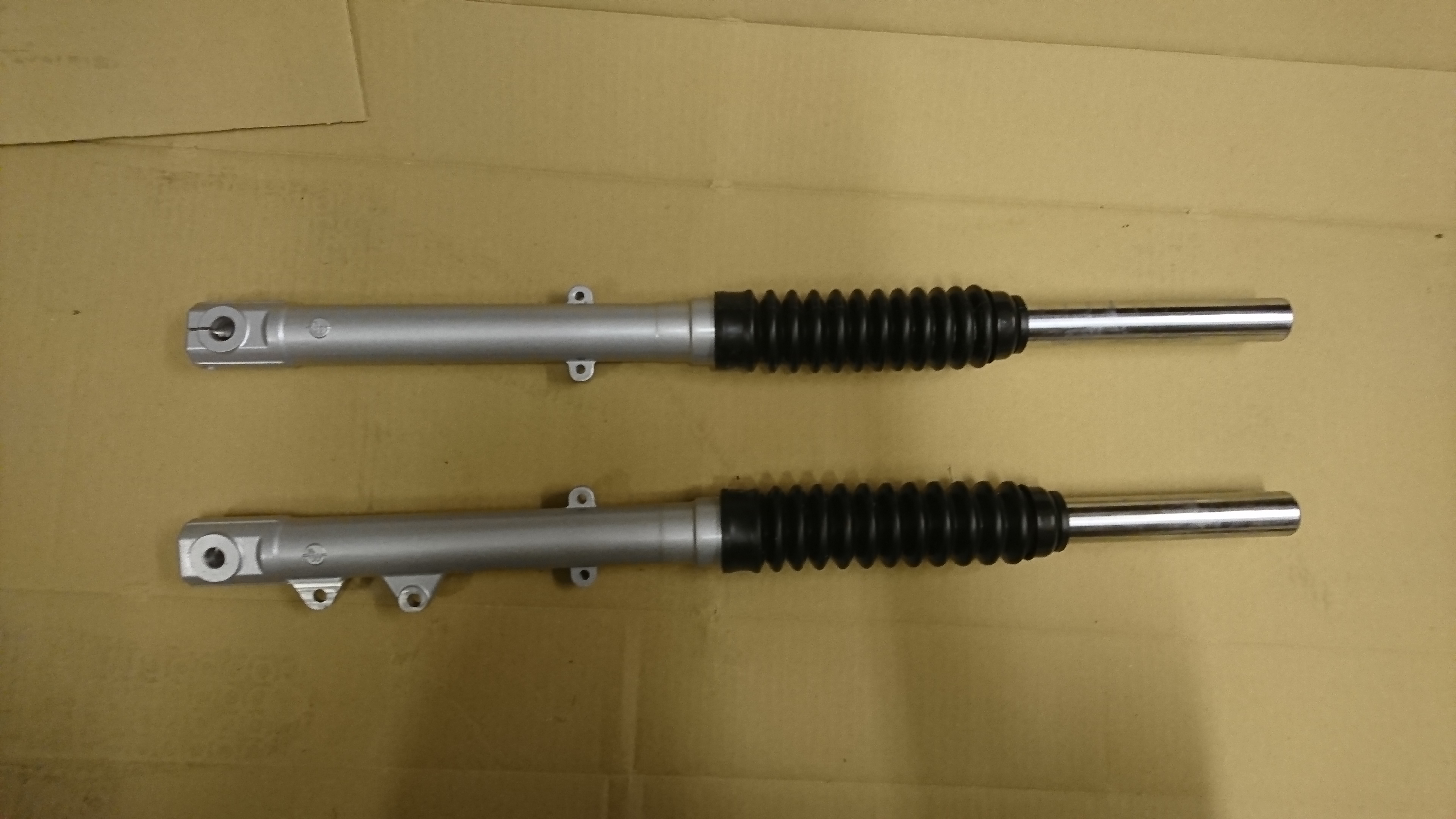

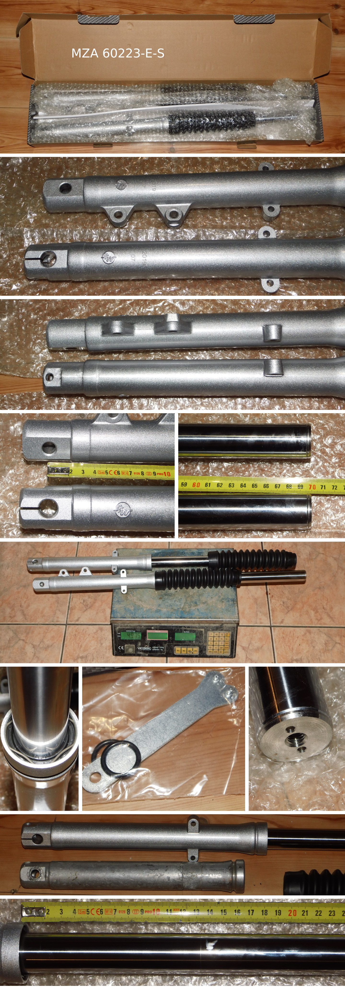

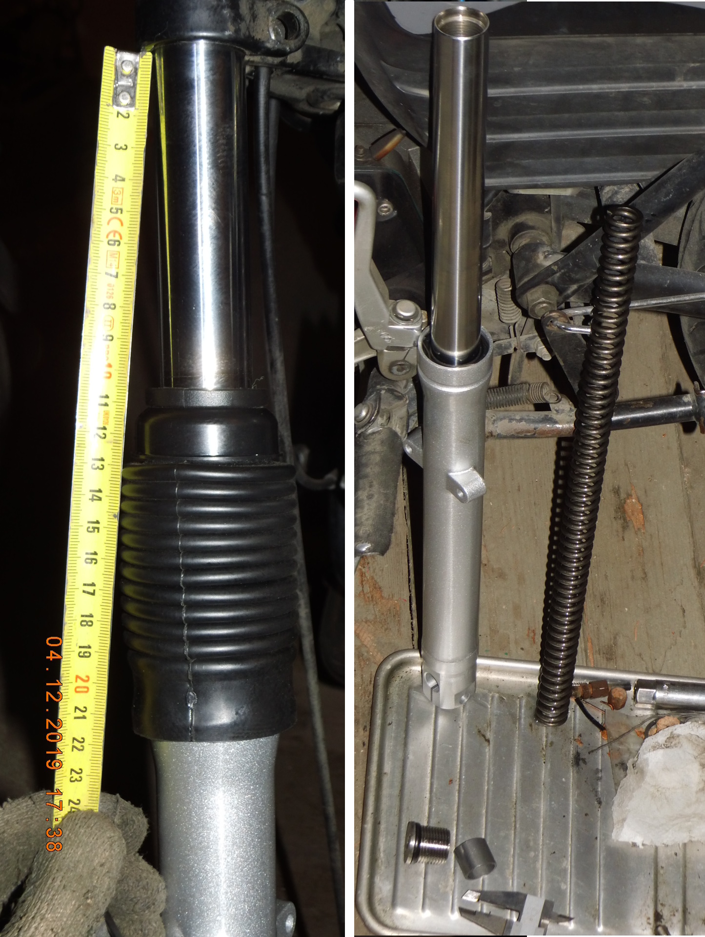

Hello.
I am the first owner of the 60223-E-S set (S51, for drum brakes) in Poland. In the pictures I present more details.
I have a few comments.
1. Suspension springs are too hard. Dimensions: 3.8 mm wire, 420 mm length, 20 mm spacer sleeve. After mounting: Static SAG 10 mm, Riding SAG 25 mm.
In my private opinion, stock S51, S53 has an unfavorable value of the head angle. A harder and higher front suspension also negatively increases the angle of the head tube. As a result, the rear suspension needs to be modified.
2. The fork legs are longer than the old DDR. This is an advantage, the fork is more stable, but it is a problem because the telescopic covers do not match - they limit the suspension stroke to 100 mm!
3. Top plugs are not a good solution for motorcycles with a flat top bridge (standard S50, S51, all SR50). Klemmbar is always the best solution.
Other data:
The old suspension weighs approx. 4.5 kg, the new suspension weighs 5 kg.
Internal diameter of the support tube: 24 mm.
Oil level: 195 mm.
Length (wheel axis - end of support tube): approx. 700 mm
Stroke: 132 mm
Spare O-rings: 20 x 3.7 ... 3.8 mm
I have questions:
AD 1. How to change springs to a more comfortable one with characteristics (N / mm) similar to the original?
AD 2. Which dust covers should be fitted? Original short, or from other motorcycles?
Greetings.

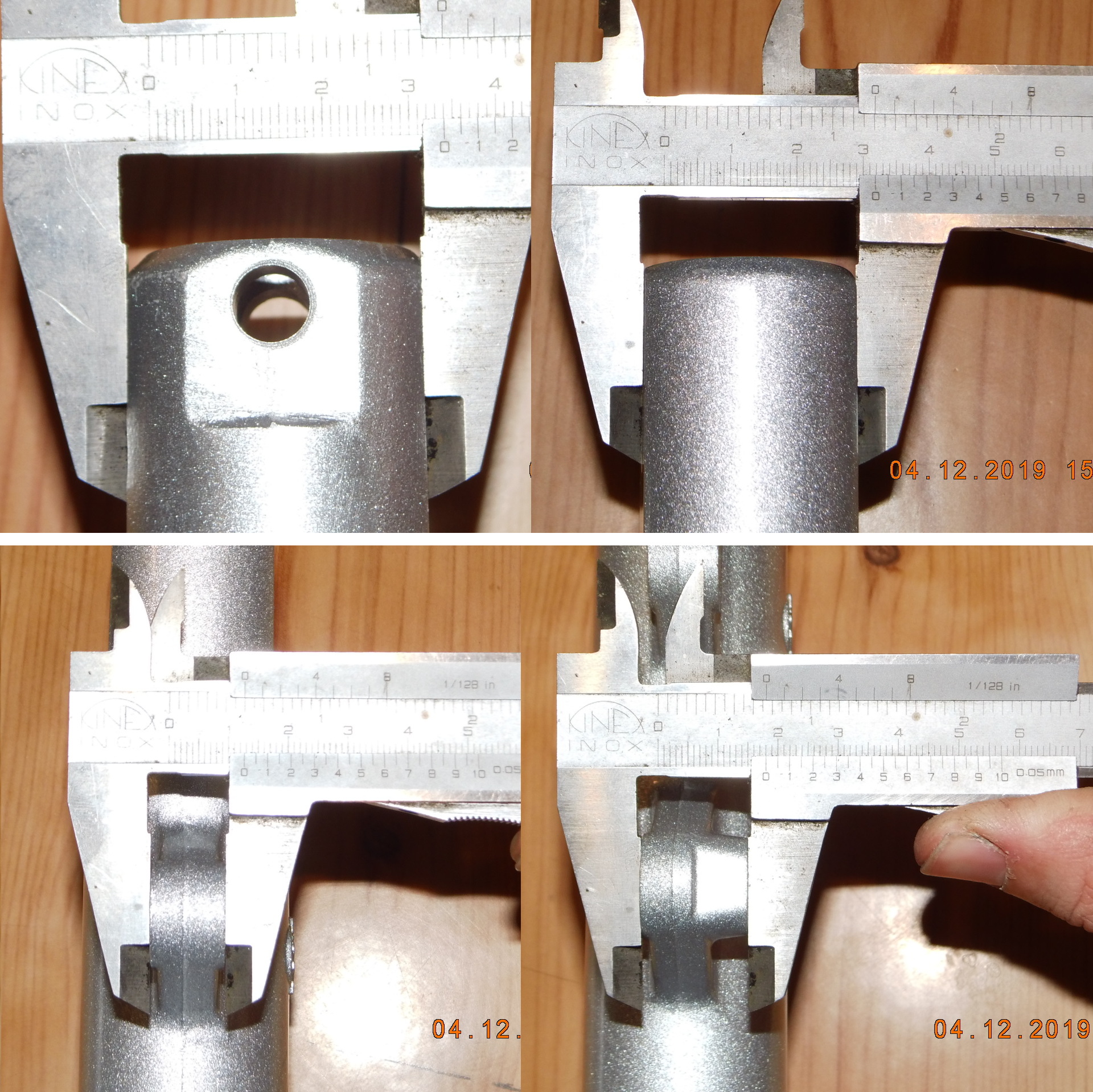

Hello.
3. Top plugs are not a good solution for motorcycles with a flat top bridge (standard S50, S51, all SR50). Klemmbar is always the best solution.Other data:
Oil level: 195 mm.
Stroke: 132 mm
Spare O-rings: 20 x 3.7 ... 3.8 mmI have questions:
AD 2. Which dust covers should be fitted? Original short, or from other motorcycles?Greetings.

Hey BananVanDyk,
You can change the oil from Telescopic 5W to 15W or 20W to make it a bit more efficient, also you can choose the original small Dustcovers in original spec, the head is this time designed after the original ones.

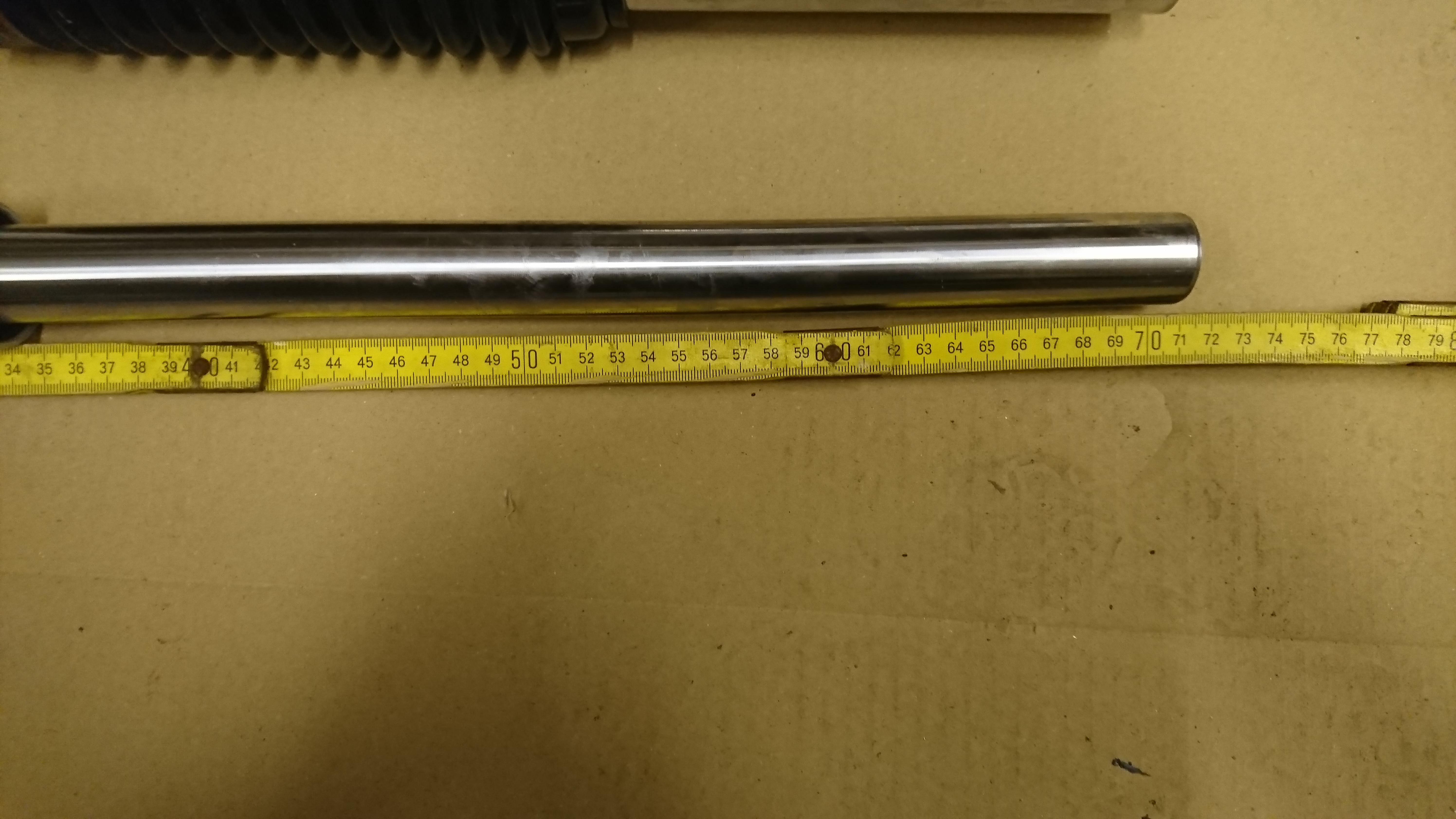

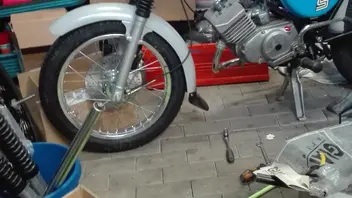

Hallo

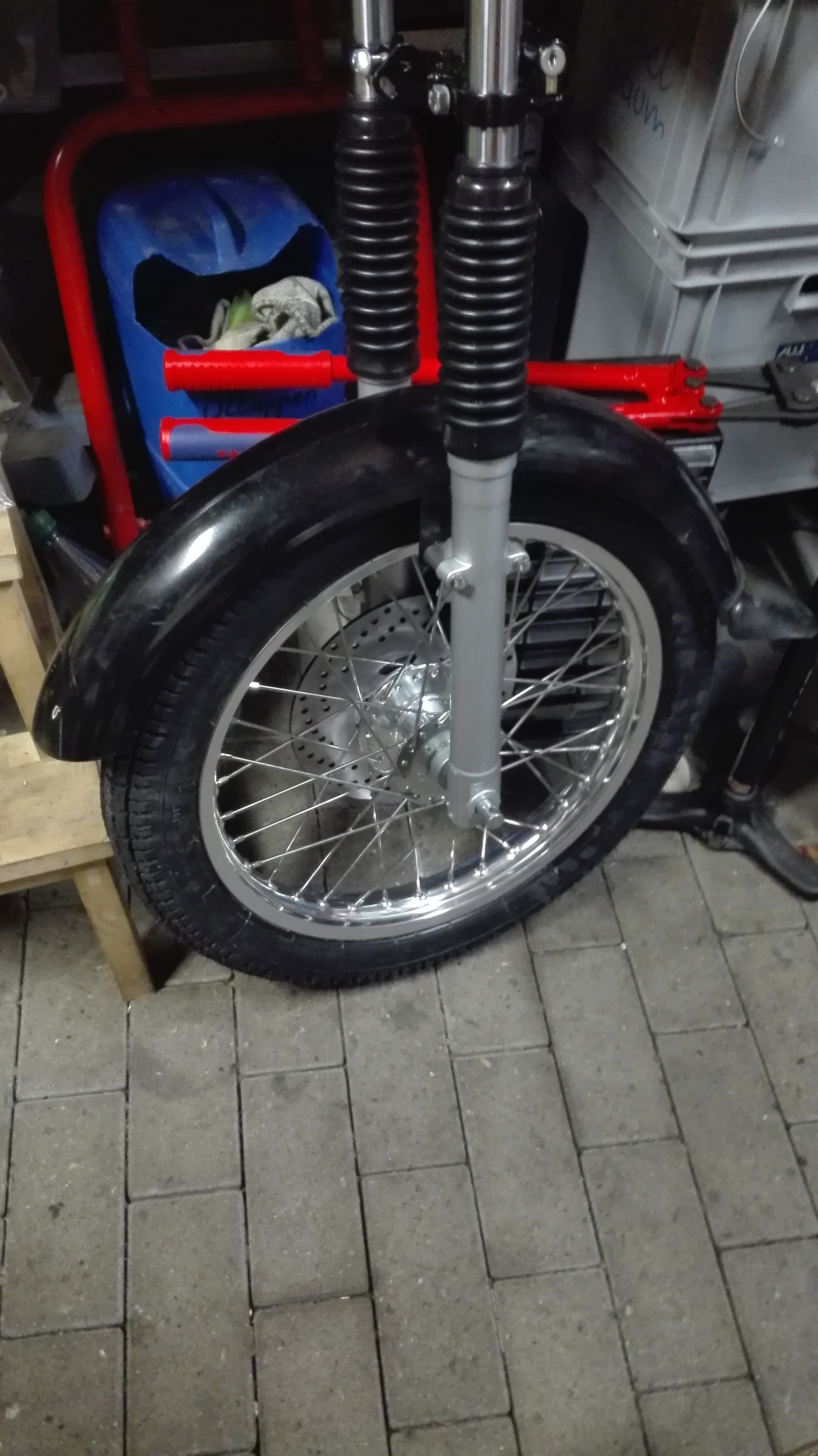

Habe mir die Gabel jetzt auch gekauft
Wollte sie im Crossmoped mit 20W verbauen
Hat schon jemand mal mit der Ölmenge Erfahrungen gemacht ?
Also Fazit ....Gabel passt nicht Plug and Play mit meiner msrzocchi ....brauche nun neue distanzhülsen für die Achse
Nicht schlimm aber hätte ma ja erwähnen Können
Gabel schaut gut aus Aber habe erstmal 165ml 20w Öl aufgefüllt
Zweiradgeber auf Youtube hatte da auch was erwähnt mit den Distanzstücken
Ich frage mich, in welchem Jahrhundert dann eigentlich die überarbeiteten Kotflügelhalter kommen... ![]()
Zitat von +Paul+Also Fazit ....Gabel passt nicht Plug and Play mit meiner msrzocchi ....brauche nun neue distanzhülsen für die Achse
Welche Achse und Distanzen hast du verbaut? Habe die SB Achse und die 6mm & 21mm (oder so) verbaut wie es original war und das Problemlos an die neue Gabel übernommen
Messe morgen mal genau aber müsste auch so sein
Habe die OR Gabel für SB und Trommel
Ich hab die 760mm lange Version. Da passten die Hülsen, die bei Ronge zu der Nabe bei sind, perfekt.
Also habe genau die selben hülsen
Habe jetzt provisorisch 3 Unterlegscheiben gebraucht um das Rad mittig zu bekommen
Natürlich passt dann der Huating Bremssatteladapter von Ronge auch nicht mehr:/
Denke mal wenn ich die NUR Sb Variante genommen hätte gäbe es keine Problemchen
Anlaufscheiben Kolben Bolzen kann man gut nehmen zum ausdistanzieren an der Achse, da die im Gegensatz zur U Scheibe Plan sind und in verschiedenen Stärken gibt
Ich denke da liegt dein Problem wo anders.
Wahrscheinlich ist die Felge nicht richtig (außermittig) zentriert.
Bremssattel dran dann die Nabe/Scheibe mittig dazu ausdistanzieren.
mfg
Kann nicht sein
Erstens ist es ein originales SB Rad, zweitens war eine originale Marzocchi verbaut und drittens originale Achse mit den Standart Hülsen
Dies lief vorher einwandfrei ....also muss an der genannten Gabel was anders sein ![]()
Außer ihr könnt mich vom Gegenteil überzeugen
Das ist doch auch klar...war doch kein Hilferuf
Sondern einfach nur meine Erfahrung mit der neuen Gabel für Interessierte
Rad ohne Distanzstücke einbauen. Bremse ziehen und schon siehst du wo das Rad steht. Passende Distanzstücke drehen und fertig.Verstehe dein Problem ehrlich gesagt nicht.
Noch jeder hat eine Drehbank
Deswegen gibt es auch passende Distanzstücke online zu kaufen in allen möglichen breiten.
Ich würde halt zum örtlichen Eisen Mensch gehen und für 5€ in die Kaffeekasse welche drehen lassen anstatt 5€ Versand irgendwo zu zahlen.
